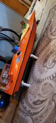

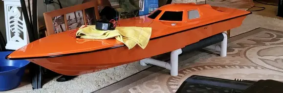

Greased and cleaned up after the pool start wishing it wouldn't rain for the next week😭 drained the tank but couldn't clear the fuel line but ethonal free it should hurt anything I wouldn't think. Shout out to Rep for telling me about the Trufuel until the marina restocks Rec90 instead of 35 a gallon lol , I had a hell of a time getting the flex cable back in had to take the collar completely off and force it in the collapsible interior thing and but a little more angle on the prop shaft to get the front end a bit more up and I can dial it in with the trim tabs. Gonna rent a pontoon boat next weekend and rip it for the whole day and see what I can break! Lol
You can also use VP SEF fuel in it and is good too. The flex cable make sure it has a slight chamfer on the end of it. This will help getting it back into the collet at the engine. Grease the cable except where it plugs into the collet at the engine. This will cause it to slip.
