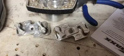

Is this normal wear on drive dogs was new never in mud only ran for about 40 mins on lake on ice never seen dirt yet and everything stayed tight but noticed the wear as i pulled pullstart casing to install emergency kill switch16152490333123320116792783088186.jpg
No that's not normal. The dogs weren't retracting the whole way.
How do they retract when spring pulls them in to center. Theirs no resistance on dogs cause have bearing style the good bearings only resistance is the springs pulling them to center
The springs are pretty strong on both sets for the motor to pull outa the way
How do they retract when spring pulls them in to center. Theirs no resistance or binding on dogs cause have bearing style and checked it has the good bearings only resistance is the springs pulling them to center
Yeah nothing binding to hold them in so must be springs to sriff
I even got the bird cage with bearings and it did the same
