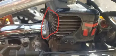

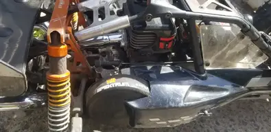

Hi on the 2 pics I posted one with a red circle I feel kinda alot of air coming from there , I'm pretty sure it ain't the muffler the air don't smell the same as the muffler ( not saying I put my nose on the muffler but I put my hand a few second at both spot the muffler smells gassy oil n the round spot litterly nothing . And it kinda feels like it's coming on top of were the muffler hooks up to the engine not the actual muffler but the gap between the engine n black plat on it that is a bit over the muffler. So is there something that turns around the engine that would create this air even when not advancing ? I looked at the engine n theres no cracks n it starts up pretty well . Thx20190913_134542.jpg20190913_134754.jpg

you might want to tighten the 2 screws holding your expansion chamber on . looks like they are loose.
