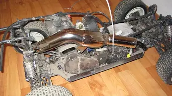

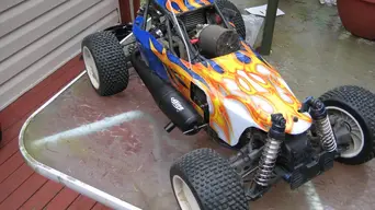

I have tried the JetPro and it is a good pipe, I personally don’t like the way it covers the throttle/brake servo and the batter/receiver box. I would have to agree with Dean and also say the JetPro is more of a top end pipe. The GBE may be something worth looking into the Baja 5b guys seem to like GBE pipes. However I would have to see it installed on the Titan first, I don’t like pipes that need to stick outside the body and I actually prefer rear exhaust pipes. I use a Samba pipe on my Titan and I am very pleased with it, it has good top and bottom end, it is a rear exhaust pipe, and it fits nicely under the stock body as well as my beetle body http://www.rc-car-online-shop.de/lshop,showdetail,30593,e,1229538917-31908,carson.carson_tuning_alu_gasdevil.sonstiges,y0956,,Tshowrub--carson.carson_tuning_alu_gasdevil.sonstiges,.htm. I would get the Samba over both the JetPro and the X-Can. I can’t comment on the GBE pipe since I have not tired one yet, it is still to new.
View attachment 1817View attachment 1818
