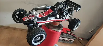

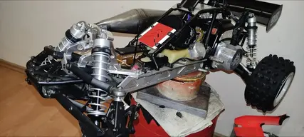

so i ordered t46 gt . it is more expensive than alx 40 by 200 euros. But Mike talked me into saying that 46 is better than gt40 and alx40. I have no reason not to believe him. in addition, I also ordered a wheelie bar + gearings 24/50. If I already have a engine at home. then I want to buy sx5 rollcage and kraken rc extended arms. I want to ask . I will also need stronger gears in the gearbox, or can the hpi original ones handle it?? . what else will I need? this is what my baja currently looks like..
Nice choice ! Congratulations !!!
Do you have blackbones gears for your transmission?
Rpm front bumper ? It's cheap but save a lot, not needed if you go with the SX5
With the extended arams you can pair them with IRC extended driveshafts
thank you broI. i still use IRC dogbone set on smallbore now too. I also have extended irc dogbones at home, which I ordered once by mistake instead of short ones 😁 .. blackbone transmission gears will have to be bought as well .. thanks for the suggestions . Mike send me the engine and other stuff Friday this week . so I assume that I will have it at home by the end of the month . I still have time to think about the build 🤔🙂
I'd get a tr or Taylor quickdiff, as long as you have the alloy diff, the hpi stuff will handle the 46gt. They can usually handle anything 50 and below.
Certainly never hurts though to upgrade if you can to the blackbone setup
