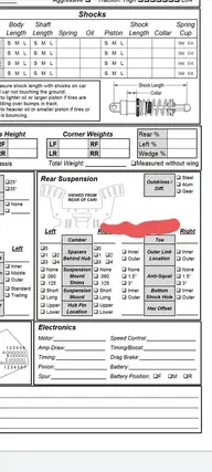

Ok so I want to set the camber on the mcd👍🏻 from the factory it came with round about 1 degree negative camber all round🤔 i want to set it to 0. Is this right 🤷‍♂️ or should I have the rear at 0 and leve the front?
Ok so I used Google and this is all aimed at 1/1 cars with real wheels
But it makes sense and maybe I should just leave the settings as the areScreenshot_20211016-112533_Samsung Internet.jpgScreenshot_20211016-112621_Samsung Internet.jpg

At one of these two locations. If you can adjust the height of that arm you can change your camber based upon the suspension movement and can use less during straight lines.
On the knuckle picture, I'm only talking about moving where the upper arm mounts and not the whole knuckle/change ride height.

The upper arm... shorter (outer hole) will cause more change in camber (neg as the knuckle goes up/arm shortens) when the car rolls and long will be less. Shorter will react faster too. You can use that in your static tuning. If you plan on racing there will be a lot of trial and error in your setup, but you'll figure out what works best. Just know the concepts of each adjustment if you don't already.
Yeah I got it 👍 thanks for the input
