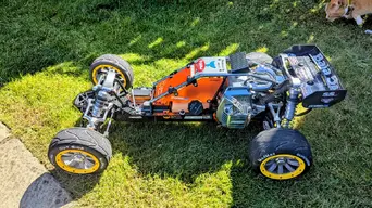

Added a couple of photos - it's in decent shapebut needs a bit of love.

Not bad for a 16 year old CY Fuelie 26cc. Enjoy your rig!

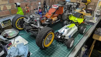

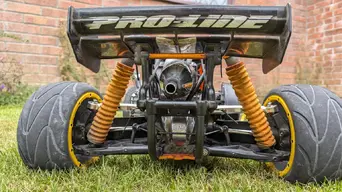

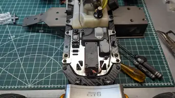

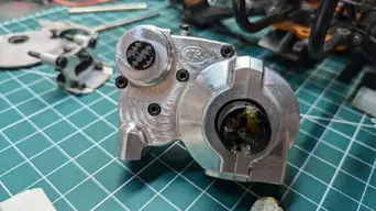

Been cleaning up the Baja, waiting on parts at the moment
