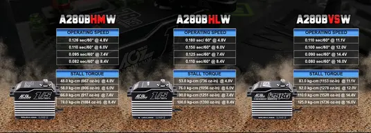

Yes they are a bit spendy. My Protek throttle/brake servo retail at £169. 😬
I have alerts set up on my phone whenever they're listed on eBay. I have a few of them now - the last one I sniped in the last 5 seconds of an auction. £85! Brand new, sealed.
In comparison, my humble Savox steering servo was £50.
I'm very impressed with AGF though - they make excellent servos. I run them in my Sworkz T2E, Kronos XTR and Losi 22X-4 Elite.
Their 1/5th scale servos will be equally impressive - Brushless, waterproof, HV, and magnetic hall effect position sensor. 😎💯
