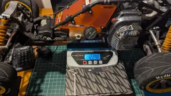

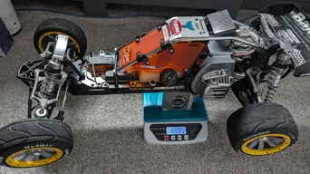

My Baja is fairly light, at a mere 13kg! 🤣
The Supergrip tyres are very heavy though to be fair. The steel roll cage is also entirely unnecessary! 😅
However, the use of Carbon fibre throughout my build has saved 100's of grams.
