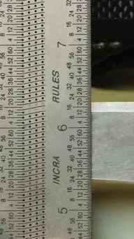

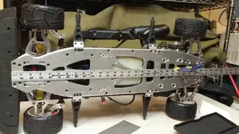

I will attach some pictures with the exact dimensions i need, and hope you guys can help me out :)
What is the diameter of the "uniball" placed in the front and back lower arm?
Thanks again!
Justin

This is the measurement of the front edge of the chassis in millimeters. 72.04mm. This is an evo4
And this is the measurement where the chassis expands to contact the down stops on the front lower arms. In millimeters. 114.79mm
Mid chassis cross section at the widest part. One pic far away to show where I'm measuring, and one pic close to show the measurement in inches. 6 5/16in
This is rear mounting blocks measured from the rear center of right block to rear center of left block in millimeters. Tool is upside down in pic but reads 69.27mm
