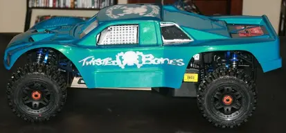

Here you go. My new dunerunner 4x4 with a 5T trofeo body and excavator tires.

Thanks for posting that pic. What did you use for body mounts? Did you have to trim the wheel wells to fit the wheelbase? If your familiar with the Rampage you know they have chassis flex. Does the dunerunner chassis flex? Is there any way to fit a bumper on front?
I made body mounts out of a pair of MT mounts. I am going to purchase a MT front shock tower as it will bolt right up and then the Mt mounts will fit perfect. the rear was pretty simple. will post more pics later. As for the body, yes I had to open the front wheel well about a half inch in the front to accommodate the extra length.
If you put the MT front shock tower on you can also bolt up the MT front bumper. The chassis is pretty rigid BUT.... the front diff plate is longer than the MT so there will probably be a tendency to flex there or worse yet bend. Will know more after this weekend when I get a chance to run it.
Twisted thanks to you Ive started collecting parts. I want to put on a 5bss pipe, hpibaja4me body, 28.5. Is it possible to buy a second brace to double the long front brace your talking about, one on top of the other? I think Ill round up either MT tires/wheels or 5t Trencher tires/wheels. Hopefully the longer wheelbase will enable some aggressive driving with tall 5t tires. My shorter MT and TT were very very slightly tipsy only with pretty aggressive driving with 5t tires. Id like to do the tower and bumper mod you mentioned too. Does the MT tower give the shocks any extra mounting points or make the shocks mount higher up?
