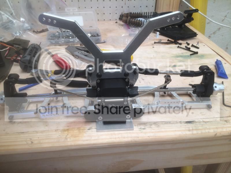

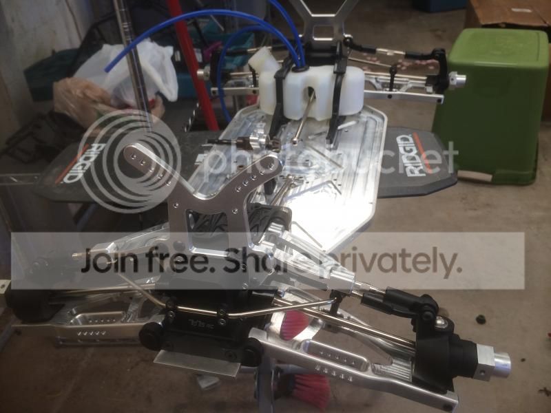

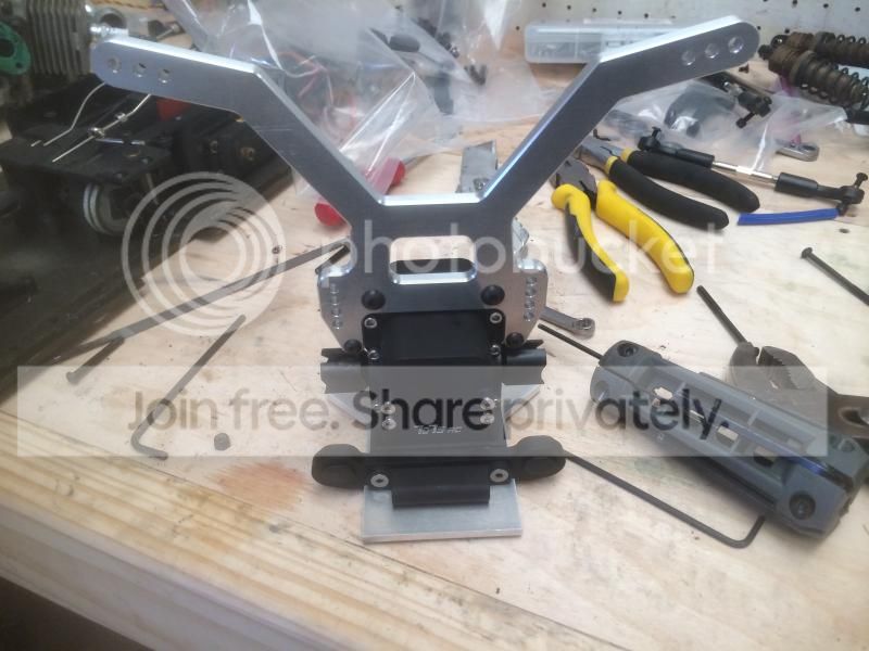

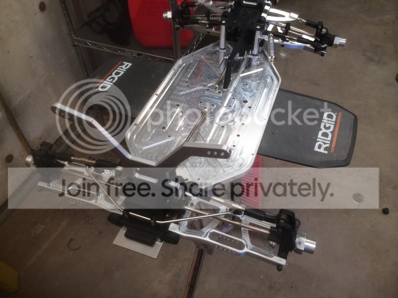

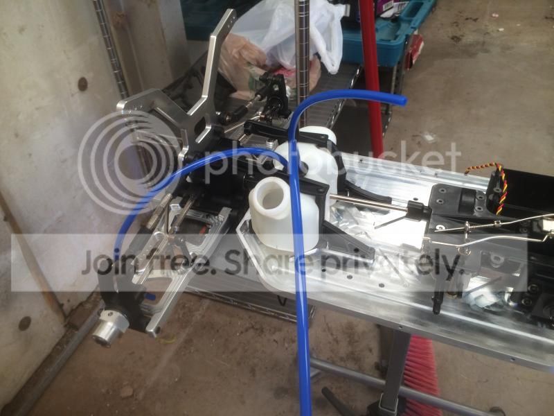

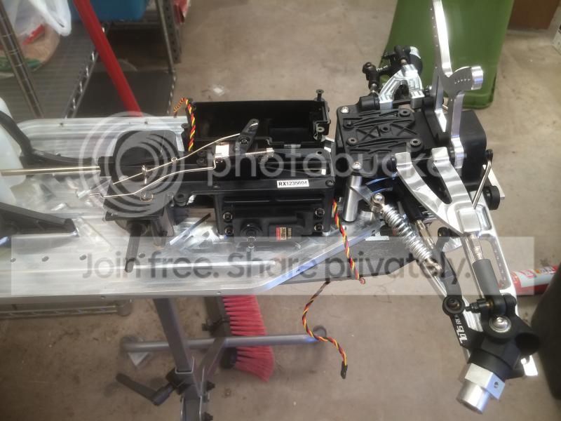

Got a little work done this morning will post more tomorrow. So far got the front diff cleaned nasty stuff out and put 7000 diff oil and got the rear cleaned out and put in 5000 oil
Steering servo mount
I think you are going to have to get the 7075 steering servo mount to make that 7075 steering servo work properly.
I have it on hand but I'm going to see if I can use the 8505 I have on hand cause it won't fit on the 7075 servo mount
I am sure I do not have the experience that most people on this site have but I am fairly handy and own two Rampages, XB and XT. I have purchased and used all the parts sold by 7075 for the X series gas vehicle and found them to perform exceptionally. I tried with negative results to use the Savox SV-0236 servo matched with the 7075 servo saver and no 7075 steering servo mount. The 7075 steering servo mount is cut and drilled for the Hitec HS-5765 servo. If you use the following parts it is pricey, but you will be happy with the results: 7075 servo saver + 7075 steering servo mount + Hitec HS-5765 servo + 2S Lipo battery = Perfect fit and Exceptional Performance.
