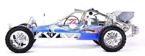

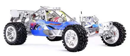

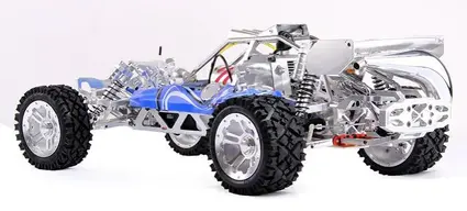

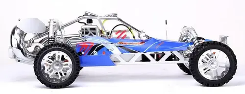

So I was lurking and stumbled upon a Chinese Baja 5b (alibaba.com), it's a 30.5CC baja 5B SS FULL CNC METAL Parts. (see pictures)
From what I've seen, it's pretty neat and tough. Vendor Claims it goes 120km/h :w00t:
now, with a discount and with shipment, it will cost me ~1560$ US
i have never seen someone reviewing this, nor i have an insight on it's performance.
My future project is to incorporate the Sidewinder X5 Kit From Kraken RC on it to make it look sexier.
Question is, do you recommend it? or should I just drop that money on a Stock 5ive T instead?

How heavy is it?
What's powering it?
Do you really want a Baja with that much bling?
Baja's are favourites by most for their sheer 'bashability', which inevitably means they will break something, which will require replacement.
Do you really want to hammer and bash that, or just 'do a Keith' and put it on a shelf for occasional starts and showing off?
Just a thought - your money, your decision.
Al.
to be honest, I have no idea. 1500$ is a bit pricey. I want to bash it Occasionally once or twice every 2 weeks.

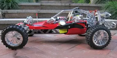

What i have in mind is to make it look like the attached picture. that rail is SO SEXY.
I want to make it look like this because I am a fan of Camburg Racing, Ive seen their work. it would be cool to have the rail's suspension and other parts 'silver shining' along with that cage.
However, the engine of the baja is a 30.5CC, single speed, around 13kg

-shelf queen. All that bling makes it heavy and if you bash it ,the breakage doesn't stop with 1 part, the impact will transfer to 2 or 3 other parts as it has no place to give. The Losi 5ive T is superior in every way, drives better, tougher, has the scale thing down, it is fantastic. I had a HPI 5B 3 years ago and sold it after a month of upgrades and lost my shirt on it. It was not a fun model for me, if I had desert in my back yard then I could see the appeal of the 5B.

That's a very good looking FG. is it for sale?
He 'broke' it and sold it in pieces / parts.

Just my opinion, but I went the same way when I started, big mistake, the aluminum parts are heavy and King motors or Rovan they are sub standard compared to say Turtle racing parts. The main thought is what do you plan to do with it, bashing you want to only use billet 6061 or 7075 aircraft machined not cast aluminum. I have since got rid of most of my aluminum parts and went with the Kraken A arms both front and rear. My upper rear arms are aluminum ( overkill concepts). The TR upper front and rear plates etc. I also went for the Kraken chassis. I guess to get to the point don't toss that kind of money for that, because you will end up getting rid of most of it anyway and have to upgrade them for better quality parts. They do look really good sitting on a shelf thought :).
