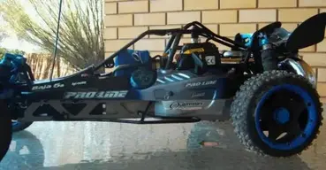

Hi I just thought I would show you guys the bar work I have made for my Baja. The parts are all made from 6mm round bar. and bundy tube.
The role gage has been made in two peaces so the front part can be removed with out removing all the suspension and brace. Where they join the 6mm bar slides in side some bundy (brake) tube.
The Nerf burs are made from the same bar and bolt to the chary with 3 bolts. The upper bar is bolted to the role cage hop bolts. The lower parts bolt to two new holes in the Chase.
I have also made a fan cover brace and a front bumper.
All the parts have been powder coted in black.

In the pick of the bumper it has bolts to mount it to the original mount. But I have changed it to pins so it is easier the remove. I would like to make other designs as well.
