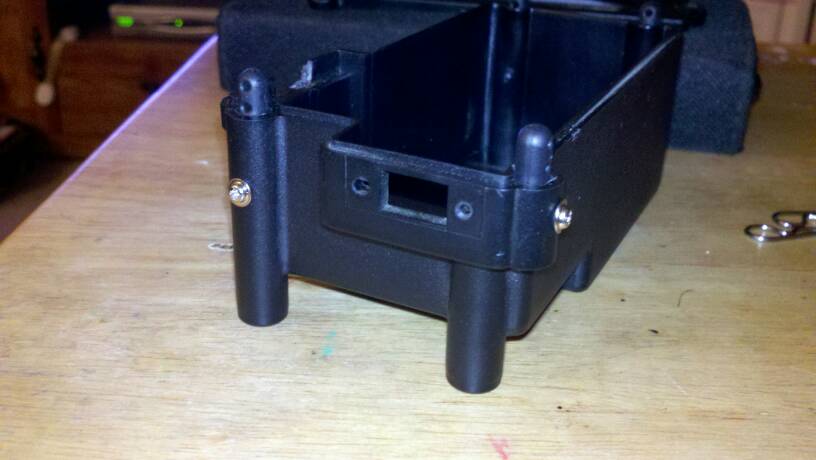

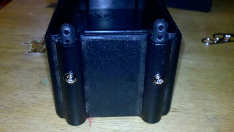

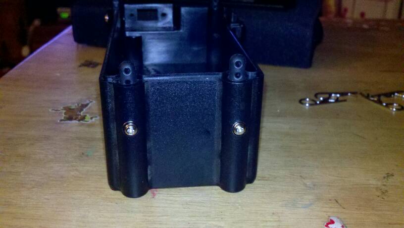

So I know I can't be the only one that hates the screws for the battery box so I came up with this. I drilled the holes to accept body posts so I can open and shut the lid with body pins. Should be much easier.

I really like that.that's a sweet idea. What did you use for the posts where the body clips attach
Thanks, I just used some body posts I had in my parts bag. I drilled the screw holes bigger to accept the posts and I'm going to secure them with a screw going though the case and post or you could just glue them in but I'm gonna put screw through the round case part that they go into. I hope that makes sense. I might even add a small piece of felt around the posts that come out of the lid to put pressure on the lid to keep it closed tightly but I don't think thats needed.
