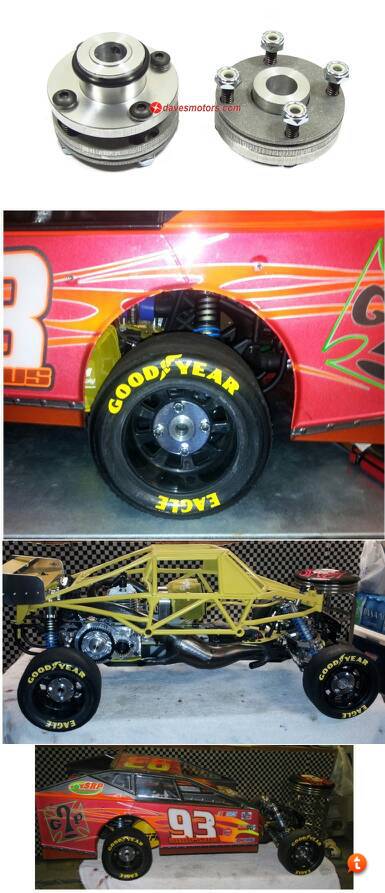

Ok so this is how the tires on your CAT will look like. (note that this is the Same rubber as Goodyear 1:1 scale drag tires)
And this is a link on all the available tires: http://www.ultimate-rc.net/department/rc_wheels_and_tires/page/1/
basically what we only need is an adapter
Those adapters will already fit on the MT without modification. Just remove the hub, slide on the adapter, slide the pin in and lock it down. You just need two sets of the rear adapters.

Won't work on the X vehicles. The axles are completely different. The MT and Baja axles are pretty much the same. I've ran aftermarket axles designed for the Baja on the MT without any modding. Pretty much a direct fit.
