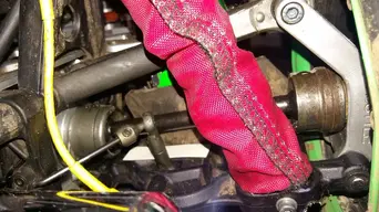

Hmmm, that looks interesting. How does the dog bone stay inside the cup? Furthermore, how does it turn the cup? I do regret running 8S, I think 6S would be better suited. However, I'm running 8S on my Losi DBXL and it's just right. I just don't want to have to buy 6S batteries now.
I run alx diff cups and shafts and they r HUGE!!!!.....
these r designed for the 70+cc range of alx engnies....so I`m sure they will take 8s no probs...I run a 7.5bhp scott finlay pro mx g32 in my baj
the pins r slotted and r 5mm I thk......
theres also the hub side cups aswell.....
