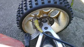

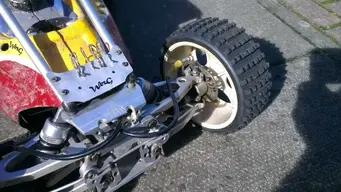

There has been a few questions and problems recently with cable brakes and I have begun to winder how you all set up your cable brakes to get the best out of them...?
To balance mine I wrapped string around the tires and hung weights from them and adjusted them so they both gripped at the same time so in theory they start gripping together and hopefully pull equal all the way..in practice its a different story and I ended up adjusting them by eye and a lot of stopping ..lol
I ended up using mountain bike cables and making up ends to suit my calipers.
What other tips and tricks are out there?:lol::lol::lol::lol:
