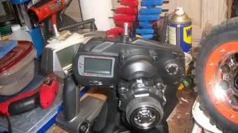

Here are two pictures of how I made camera mounts for two of my radios to allow hands free recordings with no camera wobble and thier solid. The black radio is my flysky gt-3. I ground down the head of a 1/4 20 bolt,and epoxyed it where the fm antenna went. The radio is 2.4ghz so the fm antenna is not used.The dx3c I used a hasp and the bolt goes through the center. I drilled two 1/16th holes in the case and used two small screws. 100_0491.webp 100_0492.webp
