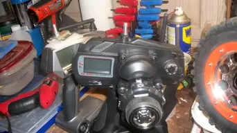

Here are a couple of pictures of how I made a camera mount for two of my radios for hands free recording.The black radio is my flysky gt-3. I ground down the head of a 1/4 20 bolt till it fit in the hole where the fm antenna went. The radio is 2.4ghz so the fm antenna is not used. The other radio is my dx3c. I used a hasp and the bolt goes through the center,and I drilled two 1/16th holes and used two small screws.These are solid with no camera wobble. 100_0491.webp100_0492.webp
Cool idea. The hardest part of making a video is finding someone to hold the camera. Can't wait to see it in action.
Yes its the same size as a tripod. I use a kodack digital camera and it screws right in,if you have a camera take a 1/4 20 bolt and try screwing it into your tripod mount on the bottom of the camera.
Thanks!. It worked. I mounted my camera on the body, hopefully I don't flip somewhere hehe.
