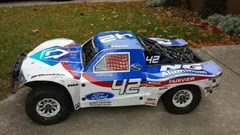

It's easier to make body penals of 3mm lexan(stock 2mm) instead carbon fiber it's less expensive and you can still paint it and it last much longer . pics is body I made with 3mm with wrap on
