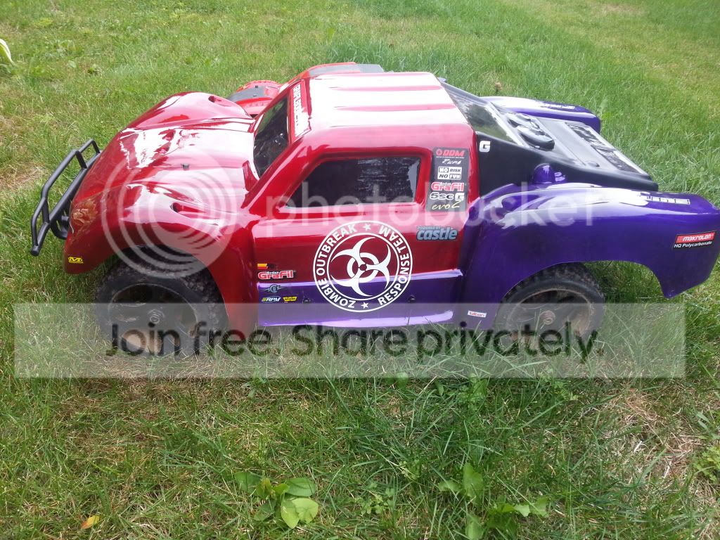

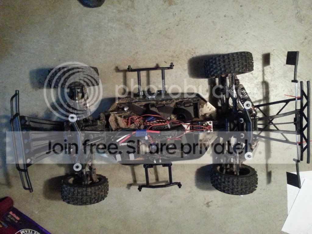

Its now a XSC-e with the addition of the Grafil Super5 body and XSC body posts/bumpers.
Messy messy rig, but here it sits currently.

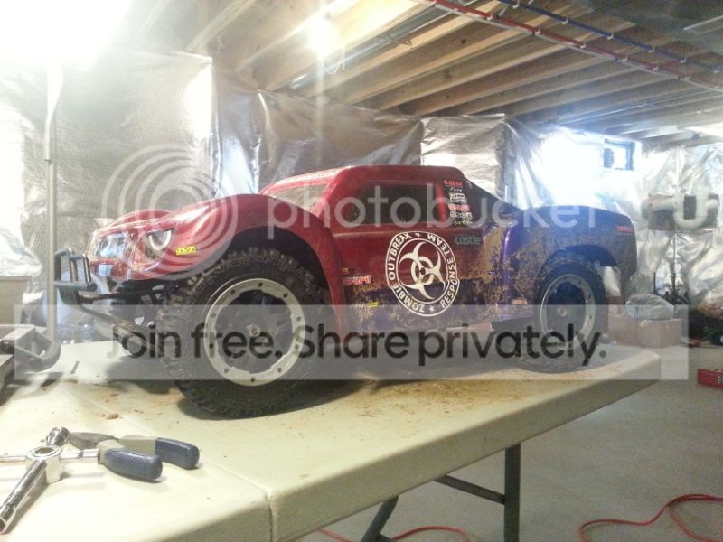

Bunch of goodies on the way! Arrived today was King Motor pioneers - Trencher knock offs.

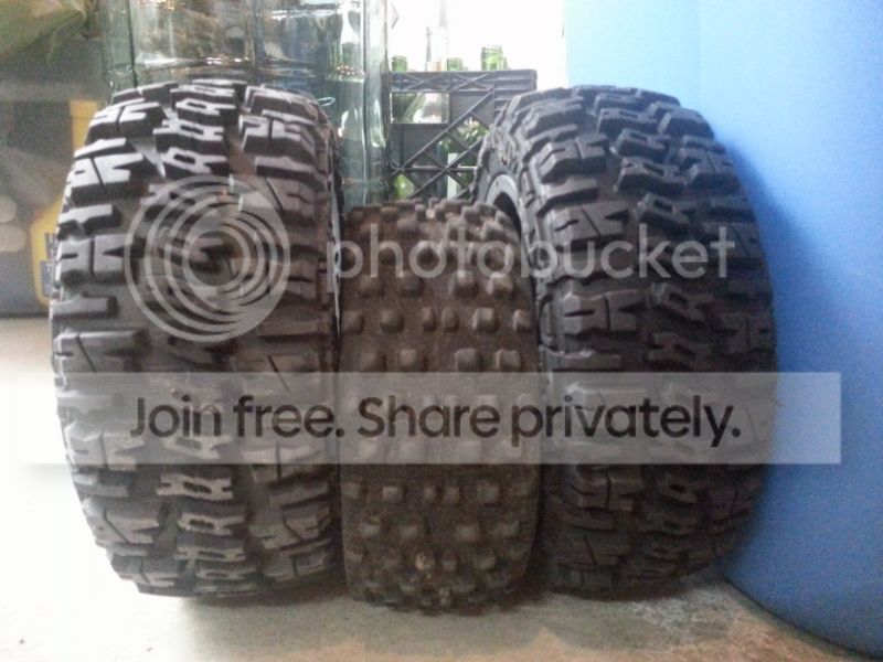

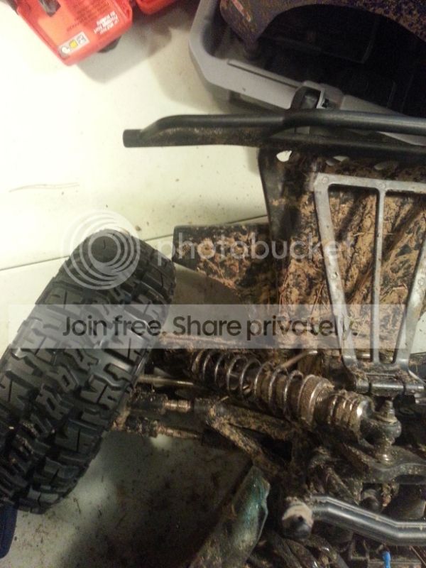

I went with the clones because they are narrower then the prolines. I wanted everything to tuck up under the SC body as much as possible. They were also cheaper to boot. Ill see how they handle come spring. I do not have adapters yet, as i wanted to see how they fit first. Here is a sneak peak in the meantime!
The body needed to be raised about an inch.
The t-bone bumper fits, but will need some trimming.
rear, stock, front.
The rears still stick out some. Ill have to see when the 7075 adapters are on, but I think I may need some negative offset rims. HPI I think makes some.
The RAMTech adapters will push the wheels out about 1/2 inch.
The truck looks great with the bigger wheels, BTW!

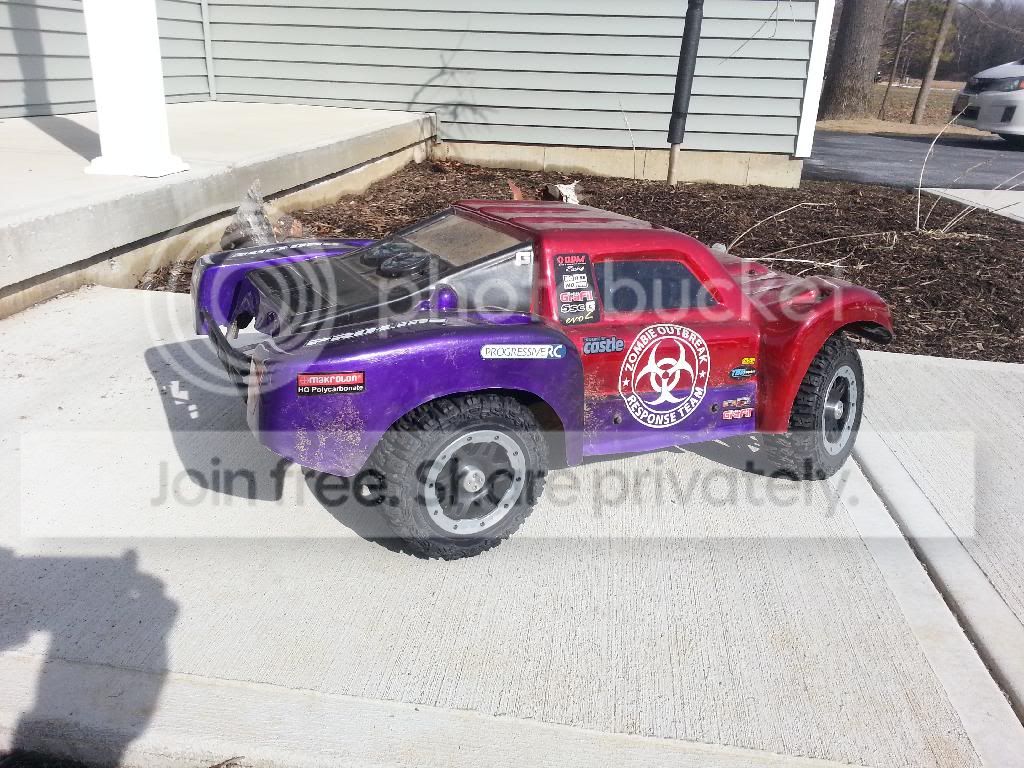

First bash with the new tires and 8s! Its a cold sunny day, about 30F so no surprise I broke some plastics.

Tires do not rub AT ALL. I am very surprised. Even if it does look a little disproportional.

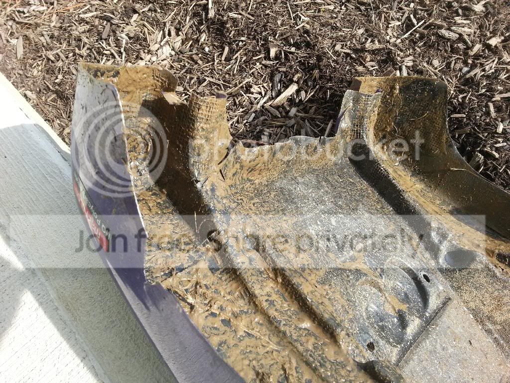

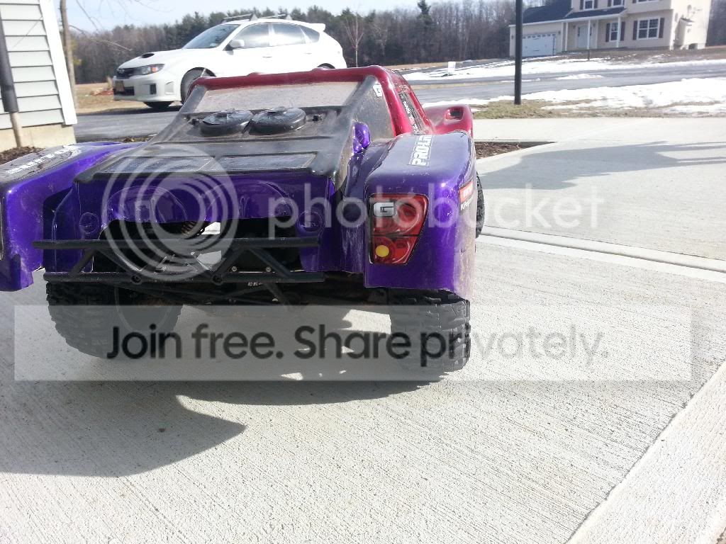

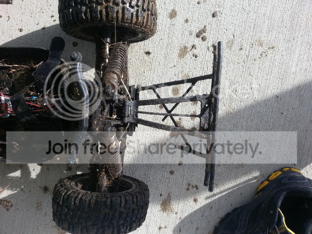

Rear bumper shattered
3 cracks/chips in the body. None of these areas were reinforced. Little shoe goo will take care of this quickly.
I have a t-bone bumper under the regular redcat. The t-bone broke during the nose down landing from 4-5' up.

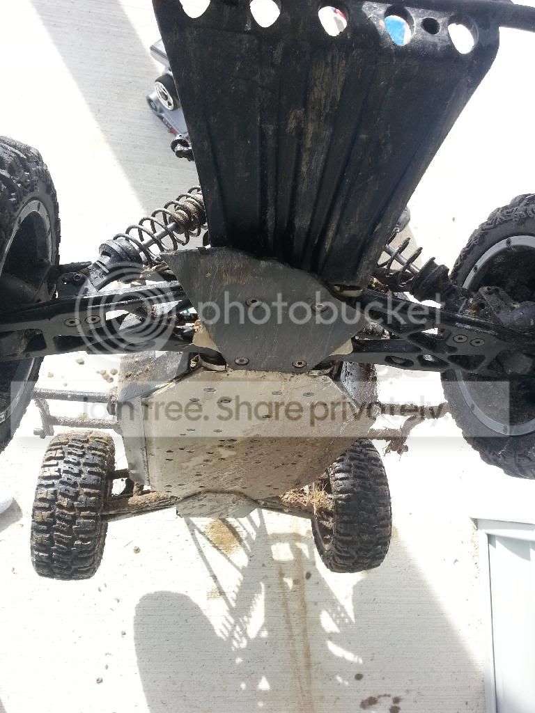

And finally, the injury that did me in. A grub screw came out of the front right cvd, causing the pin to move and lock up the wheel. this joint was locktited and had heatshrink over the pin. The joint has also become very worn... Time for a replacment. Anyone have much experiance with FLM cvd kit? Are this the correct ones for the front? ERF CVD kit XB

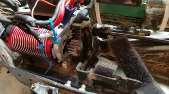

Iv been away for a awhile between saving for a house and with the birth of our fist child. I got sick of looking at that large hunk of rampage paperweight, and started tinkering over the winter. Fixing issues that annoyed me. First was replacing the motor.A leopard 5692 1090kv was running warmer than Id like. With a 12 pinion, 48 spur and trenchers, I was warm. Not bad, 175~ degrees, up to about 200 but I wanted cooler. Part of the issue may have been that the motor started as a vented can, recommended for boats. I sealed up the Vents. Probably my fault for getting the wrong can, but it was what was available at the time.
Replaced it with a sealed 5692 leopard 730kv and geared up a touch. Not sure if I had a bum 1090 motor, but the 730kv is significantly cooler. Temps were 125-150 degrees when geared for the same 45~mph. It seemed to cog more, even with timing pulled however.

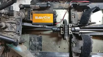

Kershaw mount and new motor went in. Will run tomorrow once locktit set up. First impressions arnt great on the mount. Directions are poor. Aluminum if soft, although should be strong enough. Fit wasn't great, but not horrible. Holes didn't line up well, some dremel work needed, ect. While the 5898 can fit with some room in all directions, you cannot fit less then a 14 tooth pinion with the 58mm can. Hardware is difficult to install. My spur didnt line up with the cut out in the chassis, but that is probably my fault, not kershaw. Motor screws are difficult to get at or adjust.... blah
On the bright side, it does allow the larger can and a front brace.
The finned leopards appear to be higher quality, at least on the outside. Longer shaft, fancier can , better wire exits and better wire insulation. Will see how running feels later.
First run, and everything seems to be playing well together.
I am worried about the gearing however, a 14t pinion with the 41 spur is too tall for the trenchers. Top speed (70mph per online calc) is not obtainable on the street and motor temps were over 110f after only a few min. Temps would probably stay in check with a fan, but everything would benefit if I could gear down a few teeth.
With some spacers, the 7075 48 spur may fit. That will be a project for another day. Till then, I am fairly happy with the motor.

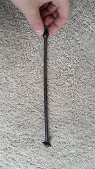

When comparing the old center shafts to new ones, I noticed there is a twist in the old ones. Is this normal? The new ones are lined up perfectly.
If you move the front plastic chassis brace to the right side, it frees up some space for smaller pinions. With the 58mm can, the smallest you can go is a 11 tooth. With a 56mm can, a 10 or maybe a 9 would fit.
New holes had to be drilled.
Space left. Its a little closer then Id like and will probably move to a 12t pinion to widen that gap some.
