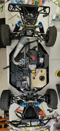

Clutch mount? I put the stock clutch housing and stock clutch carrier that came off my 2.0 onto the 1.0 and it fit with no issue. I did have to use a cy clutch holder tho because the clutch made contact at the very outside edge of the clutch bell.
the stock clutch mount? i believe it should work. the v2 has a cutout because the center diff is closer to the engine to fix that drive angle where the v1 didnt need it.
clutch housing though is different since the v1 came with 29 vs the zen32

@MonsterAir if you use the g320 it will fit as I stated above as I have 2.0 stuff on my 1.0.
Thanks @Rep732. That's what I needed to know/ See 👍. Losi calls that front piece that holds the bell the clutch mount in their manual. Thanks for your help as this seller does not accept returns. Good price too so don't wanna hassle the guy.
