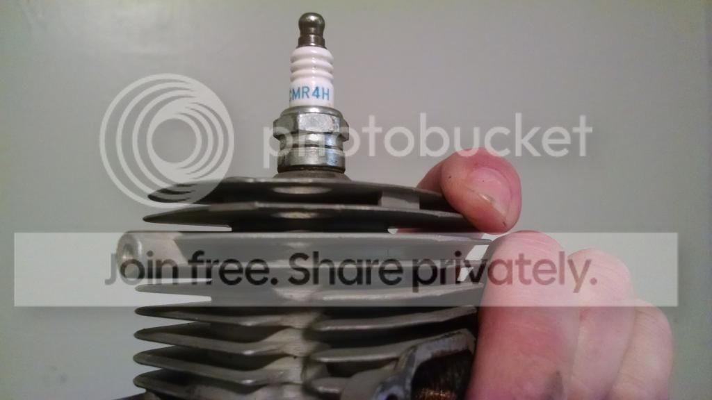

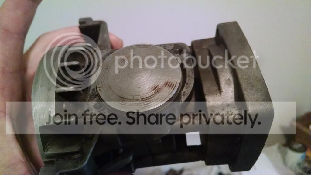

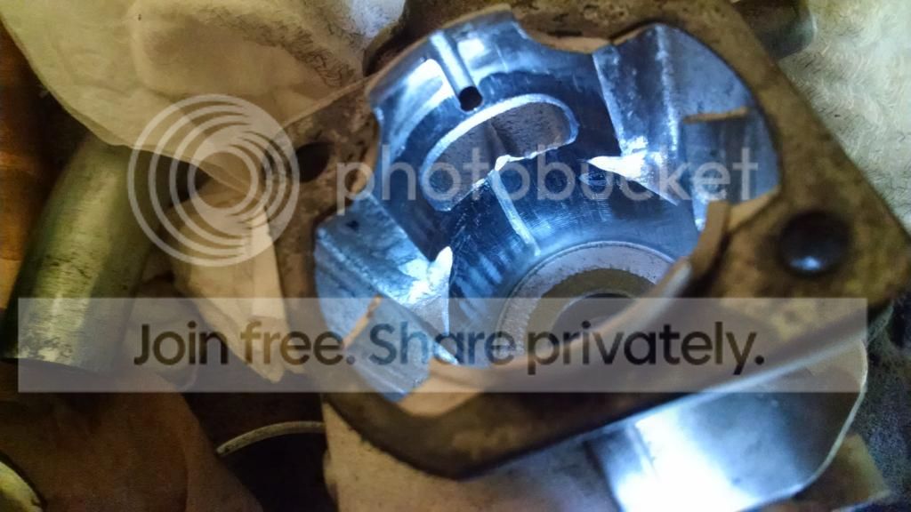

Hey Phill... You wanted to know what the piston looks like after 3 gallons on a cmr4h plug.. IMG_20140830_172643966.webpIMG_20140830_172741315.webpIMG_20140830_172956710.webp The only issue I had was non plug related lol. I snagged a ring on the intake and broke off a piece of ring as you see the groove in the head and 2 smash spots on the piston. As you see no melting of the piston.

BertR said:
Hey Phill... You wanted to know what the piston looks like after 3 gallons on a cmr4h plug.. The only issue I had was non plug related lol. I snagged a ring on the intake and broke off a piece of ring as you see the groove in the head and 2 smash spots on the piston. As you see no melting of the piston.
Looks good Bert
Ya know Phill...if you had not been curious about the plug I never would have pulled the jug off. Glad I did with the grove it was cutting in the wall, you can lay a toothpick in that nasty slit lol. Back to the drawing board with another stock head and ring....I can do a better one for sure....Ildy I will document to the best of my ability and send it on to you to have fun with.
It's a wonder it was still running Bert
I've got a 2 bolt CY with a smaller groove that won't run at all
Cool thanx I can't wait to see the progress....
