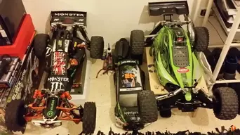

Got a use 5b 26cc instead. :)
And yes it's genuine HPI I double checked
Pretty rigged out. All integy Aluminum tho, gona upgrade them slowly to FLM and TR products.
Has the Power steering Control installed on. Bow tie trenchers, gt3b radio. Battery led indicator. Some pretty cool decals
1st things first.
New hv servos and 2S batt coming up
