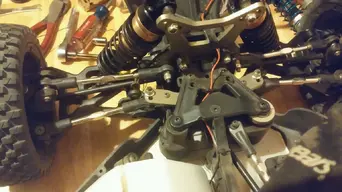

So I just swapped out the bell crank do I need to swap out the steering arms the original arms seem a bit long anyone with information will be greatly appreciated...
@Losi125 I'm not sure what you are calling steering arms. It may be what I call tie rods. I believe the drag link/ackerman arm is different. So, here is a pic of my 2.0 front end. If you want to circle any parts and repost the pic, I can hook you up with measurements and part numbers.

Yes the steering tie rods I had to shorten mines a little everything is all sorted thanks for the reply
