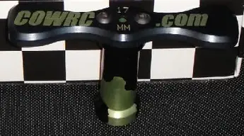

You know I had to do the Matching wrench ;)
