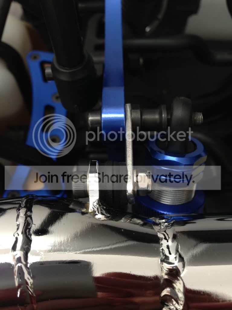

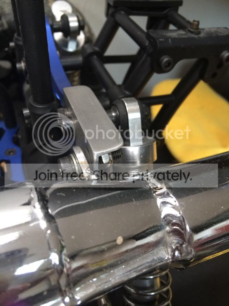

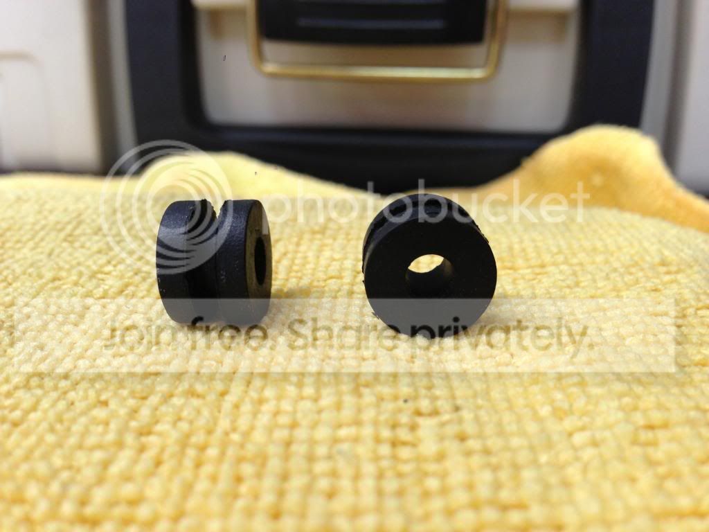

I use rubber bushings to give a little cushion between the pipe and the tower. The pipe really transfers a lot of the shock from the tower to the engine braking the fan case mount. I have used the aluminum cover for several months with no issues yet.

is that the CPI pipe in the pic?
Yes, it's a CPI pipe. The only other issue is that the aluminum mount you get with the pipe is worthless. It will crack running over sand paper. So I have been using angled aluminum and it has been working really well.
where did you get bushings from? thanks for pics was thinking maybe I could cut pipe down an inch and reweld it so doesn't stick out as far off truck
cpi pipe
Home Depot hardware section. Buy a couple of different sizes along with a longer mounting bolt. I wouldn't cut the pipe down, just reinforce the pipe mounting. You will inadvertently affect the performance of the pipe.
