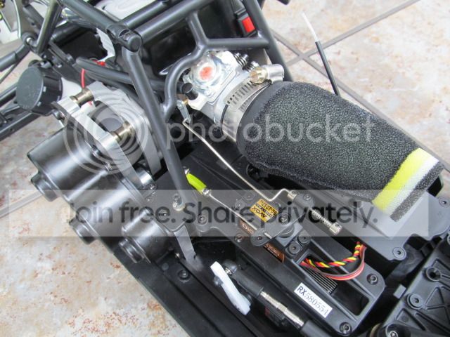

Ive got a 5mm LR in my XB, its alittle close near the primer bulb and near the plug...ill see if i can dig up a pic.
This is the best pic I have, and keep in mind its a 5mm LR.
Obeast44
man that looks like a DT1 filter ??
man be super vigilant keeping an eye on that set up in fine dusty or sandy conditions..
a couple of baja guys have eatin' motors using them
just a heads up amigo.

I run the dt-1 filters in total talcum consistentcy dust- 2 stage- when it gets this bad I use Maxima fft filter oil- soak the filter in a baggie- use a lint free towel to remove as much of the oil as i can- inside and outside surfaces of the filter- no scarring on the jug so far-- in lesser conditions- i use no-toil.-

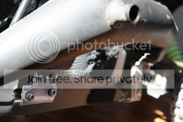

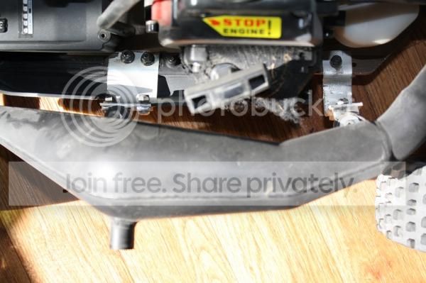

this is the homemade pipe.- bought it during ddms sale. crappy brazing- but- its air tight! - have since turned the pressure down on the aceteline and oxygen- hooked up an old victor jewelury-spelling-aggg- torch with flash back arestors- torch mount.- no more running after the molten puddle.- yes, its a butt joint and yes bronze weakens with heat- so far-so good- noteven a wet spot on the joint.- use the pipe to rest my knee on when i pull the rip cord.- the photo- this was before i brazed up 2 small mounts on the belly of the pipe.

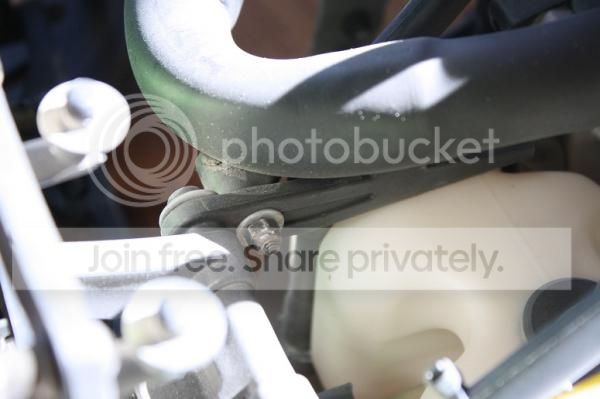

Hmm looks like he moved one of the rear cage mounts forward, trimmed a side guard and bolted two angle aluminum pieces to the chassis so the stock mounting hardware could be used.....wow run on sentence!
If it was me. I would add a coupler in the straight section to help space the pipe back a half inch and then mount it. That should give you plenty of clearance for the body and cage.
