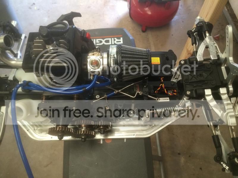

Looks very nice that is not an HPI filter that is an aftermarket filter. With the hpi filter you will not have to run a stack with the filter.
I'm just curious on what kind of setup works best as far as carb,stack and air filter setup on there chimera,I ready to upgrade and just don't want to get something on just "looks" alone
