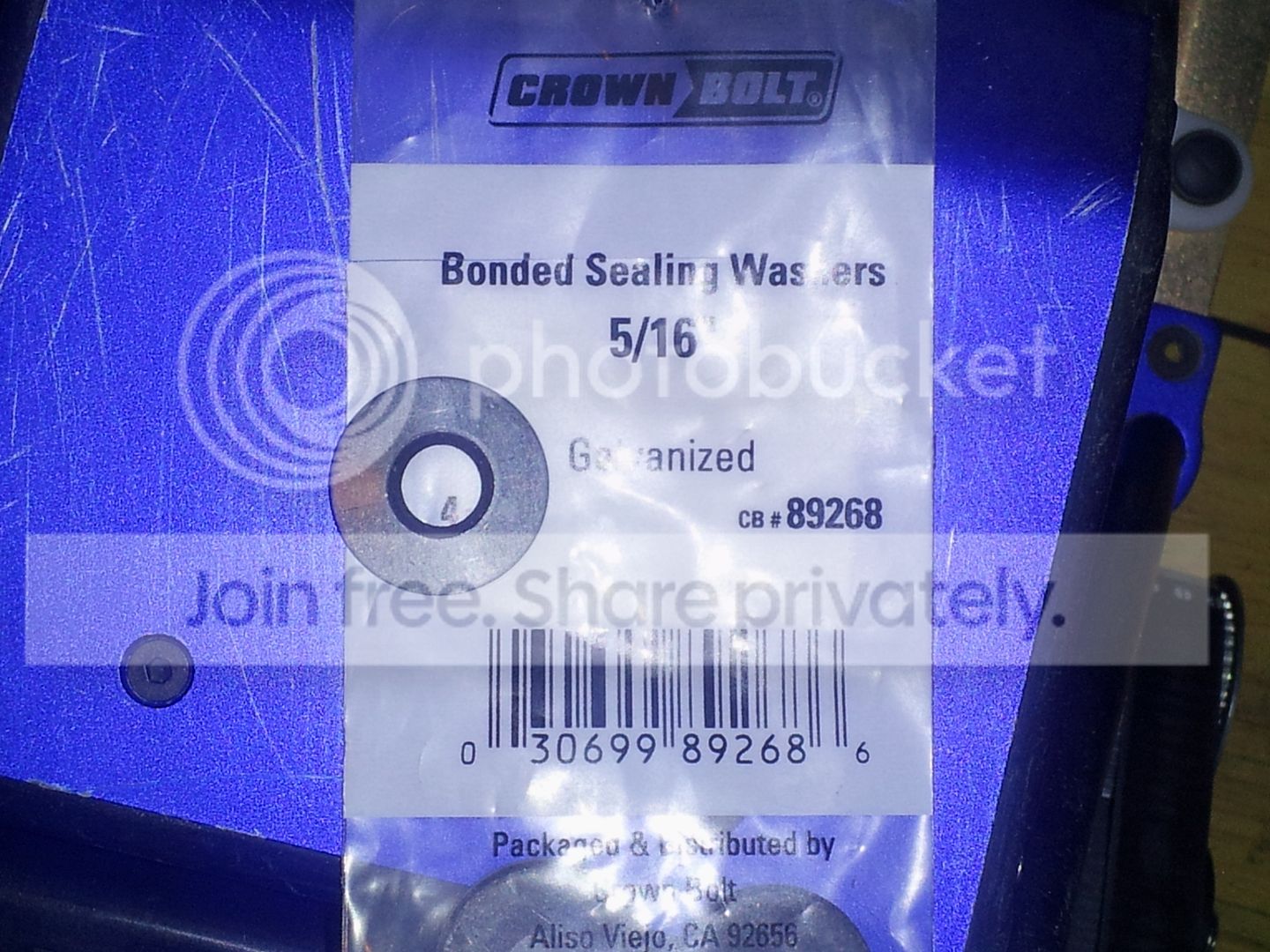

What worked to keep the pinion shaft pulley in place, while keeping the tension on the bearing inner race only.
The washers have a cone shape, place the fiber against the pulley and the small side against the bearing. And the belt drive is in alignment. What I was checking in my video was how this was working.
