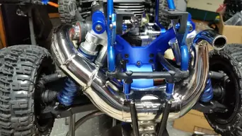

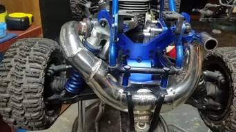

Been wanting to upgrade the shocks on my DR for awhile now. Thought I'd like the piggyback pro shocks redcat offers on there, but was concerned about clearance using the jetpro pipe. What I did is mount the shock with the reservoir to the inside rather than the outside. Seems to have plenty of clearance. Will update after I actually try them out. What shocks do you guys use?
20180405_002835.webp All cleaned up. Both shocks installed. Filled with 50w oil. May have to go thicker once the weather warms up.
Have they got any more "bounce" in em than the stockers?
My DR suspension feels dead.
I haven't put it on the ground yet. I just fitted the rear shocks, now on to the front. I'm hoping for the best
