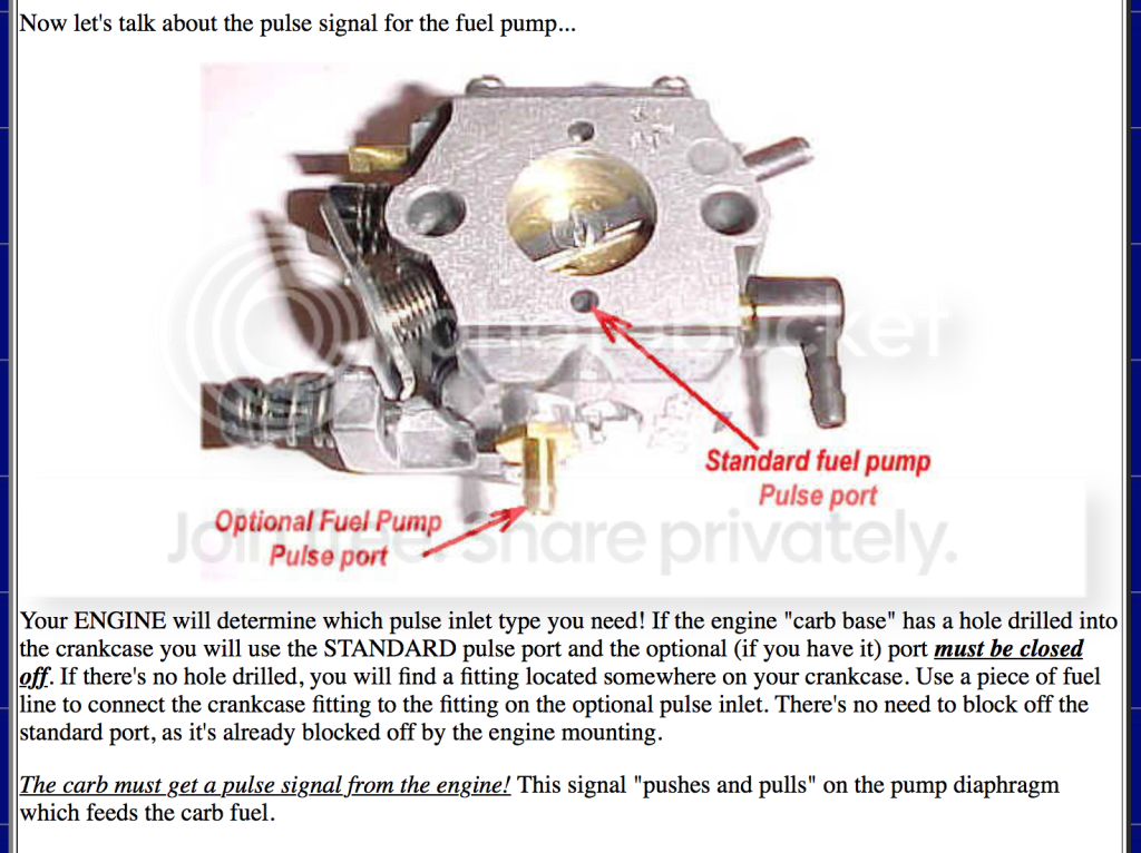

One more question on installing the WT-1107. I also got the ADA manifold, my question is regarding aligning the holes in the manifold with the holes in the carb. There are obviously 2 large holes for the bolts and then the carb has another two small holes, but the manifold has only one.RampageHopUps said:No gaskets with new carbs.You should be able to use the old ones, as long as you change them in the next few weeks. After that, they will tear when you take them off.

Need helpIce_2k said:One more question on installing the WT-1107. I also got the ADA manifold, my question is regarding aligning the holes in the manifold with the holes in the carb. There are obviously 2 large holes for the bolts and then the carb has another two small holes, but the manifold has only one.
Post a pic so we can see what's going on.Ice_2k said:Need help![]()
According to Zenoah the tiny hole (on the bottom of the carburetor) is called the standard fuel pump pulse port. In one world the carb receives pulses and pushes from the crankcase through that hole. When installing your billet manifold, make sure that tiny hole is at the bottom as the standard pulse port (if equipped) is on the bottom according to pic below.Ice_2k said:Here it is
I wish I had my spare carb on hand, I could swear the top hole is not even a through hole.Ice_2k said:Great stuff man, thanks a lot! So the bottom hole is the one I need. Just wonder what the top hole was for...
Yeah I checked on my spare carb too! Good to know!Ice_2k said:You were right, the top hole is not used. View attachment 7667
