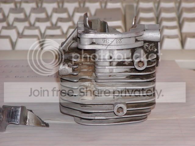

Ok so I recently got a redcat rally used and I'm trying to figure out the engine size so maybe you guys can help. From the factory it come with a 2 bolt 23cc or 28cc hy engine. The motor that I got with this car has a serial number starting with HY30****. I'm assuming this is a 30cc motor? I've looked up the serial number and no results have been found on google. If it is a 30cc 2boltHY motor it has a coper head gasket, so the head might be aftermarket. how could I tell if it has an after market head? Doesn't look ported but displacement might be different, is there any way of telling with out disassembly of motor?

you can look at the base and get a idea of the bore it has two sets of numbers the last one tells the bore the pic below says 28-36 so the bore is 34 with a stock crank it will be a 28.5 cc a 34mm will be a 26cc the 32 is the 23cc motor
