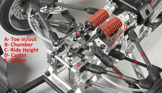

Hope this might help, keep in mind this this to a FG F1 Competition. If you need one for the Sportsline let me know. I can either use a pic online, or it might be better if you could upload a picture on this forum, so I can mark up the picture of your car, just as I did this picture.
If you need setting I could provide you with the setup I currently have.
Thanks for the help, so adjust the ride through springs is wrong, it should be done through the (c) rod.

If i adjust ride height through the rod linkages , how do i adjust droop. As the sports line model is different to the competition model, FG don't have a guide on what does what on the set up side, what each linkage does. Im only new at the f1, so sorry if i ask all these questions,. We are trying to start a class up here in Australia. Most of us are new at the f1. But we all run the touring class

How do I adjust the rod for ride height (c)?
FG Formula 1 Competition ride height adjustment - Do I disconnect the upper bulkhead and just screw in/out the rod into it or is there another way to adjust it? It came pre-assembled and doesn't seem to want to move easily, also doesn't have a lock nut, which makes it seem that it's position is fixed and not adjustable.
