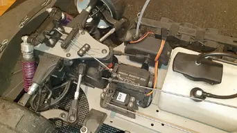

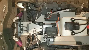

I ended up buying servo retainer (FG 69241).
I then needed to move the receiver box. For that I needed to drill 2 holes.
Before:
After:
