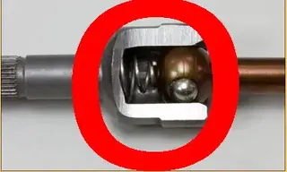

If you can't go the universal drive shaft route, consider placing a small spring, fuel tubing, or foam spacer or between the drive shaft and diff drive cup.

He's got dogbones, wouldn't that spring pushing out exaggerate the problem?
If the issue is happening when driving straight, duel springs could be considered. If it's happening when turning one spring will push the dog bone out and into the hub drive cup. Since springs are much cheaper then a set of $100+ universal drive shafts, best to give it a try.
