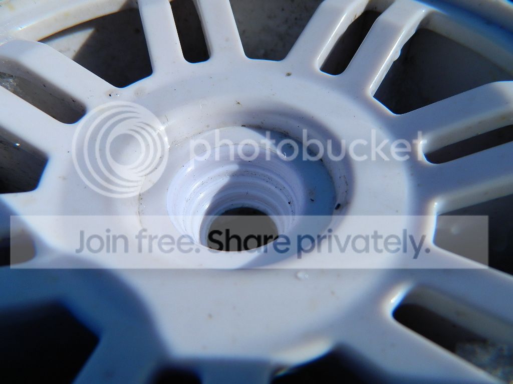

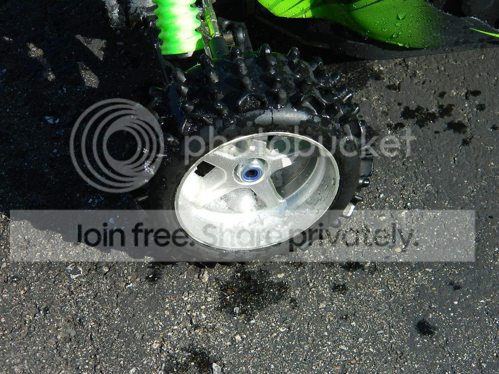

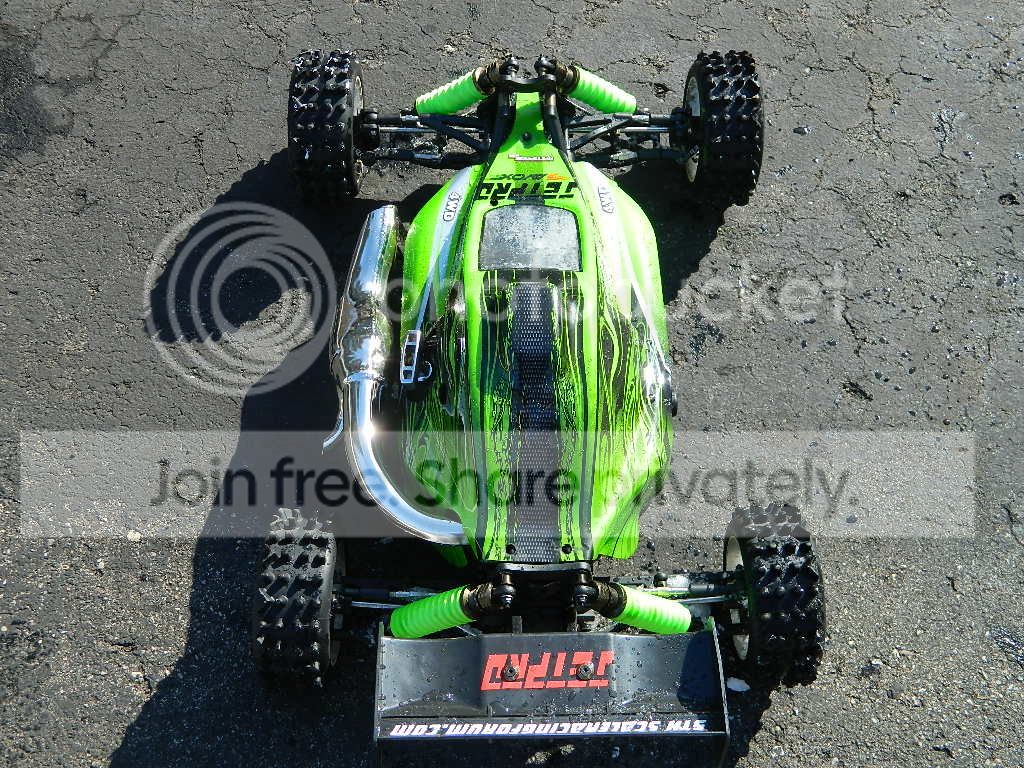

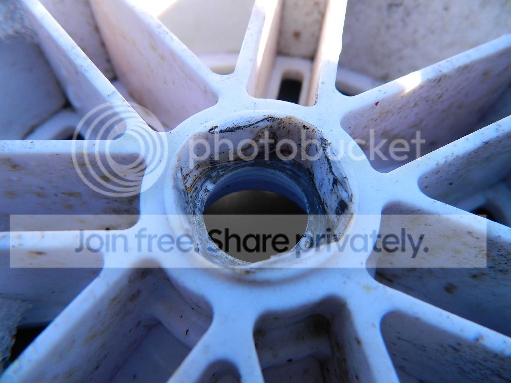

I have the 10mm stub axles on my XB and I just drilled out the wheels with a step drill. The ridges leave a ledge for the wheel washer to seat into. I've jumped this thing 10 feet in the air and never had a problem, these FG Marder wheels add 2 inches to the width. These are SO much better than the beer-foam filled stock tires.
