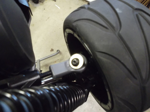

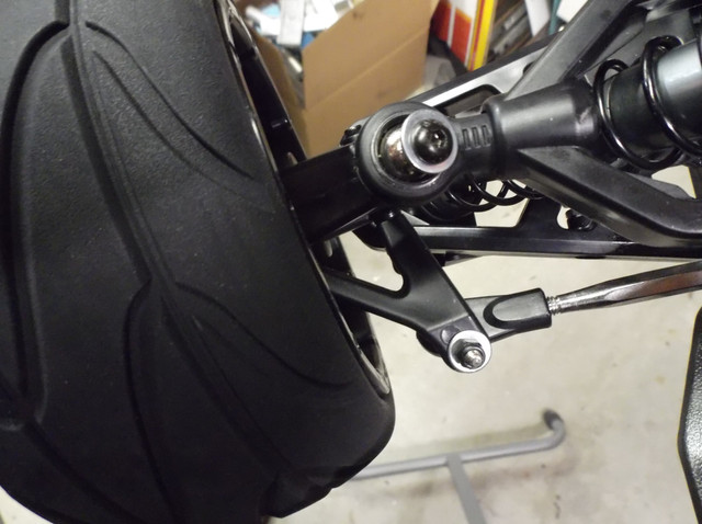

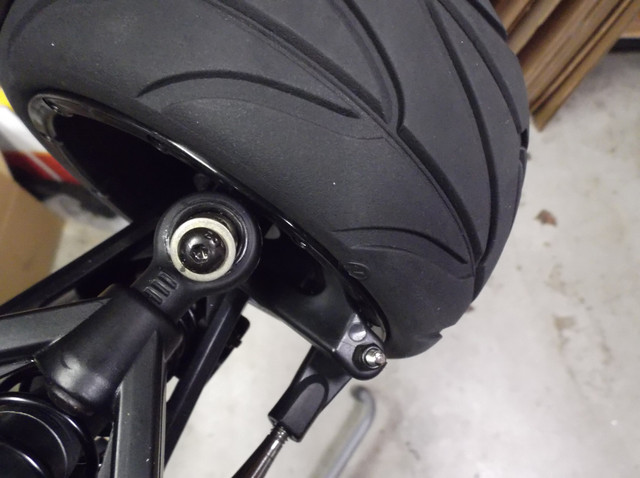

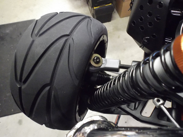

So I wanted to run the MadMax 180's both front and rear on my Rovan truck and it was initially a no go. Because of the different wheel offset on the MadMax rims the inner bead lock will come in contact with the outer tie rod ball end. I ended up having to buy the Rovan hub extender kit. Not a big deal, as i'm glad as the hub kits do away with the front hub "C" clip design and use a bolt and inner bearing flange to retain the axle within the hub. I like the Max's as the rim uses a reinforcing metal sleeve around the hub hex. The Max's have a very nice snug fit on the hubs. Here's some pics :

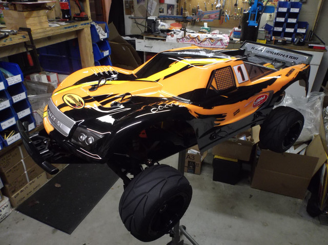

Looks great with the on-road sneakers :
