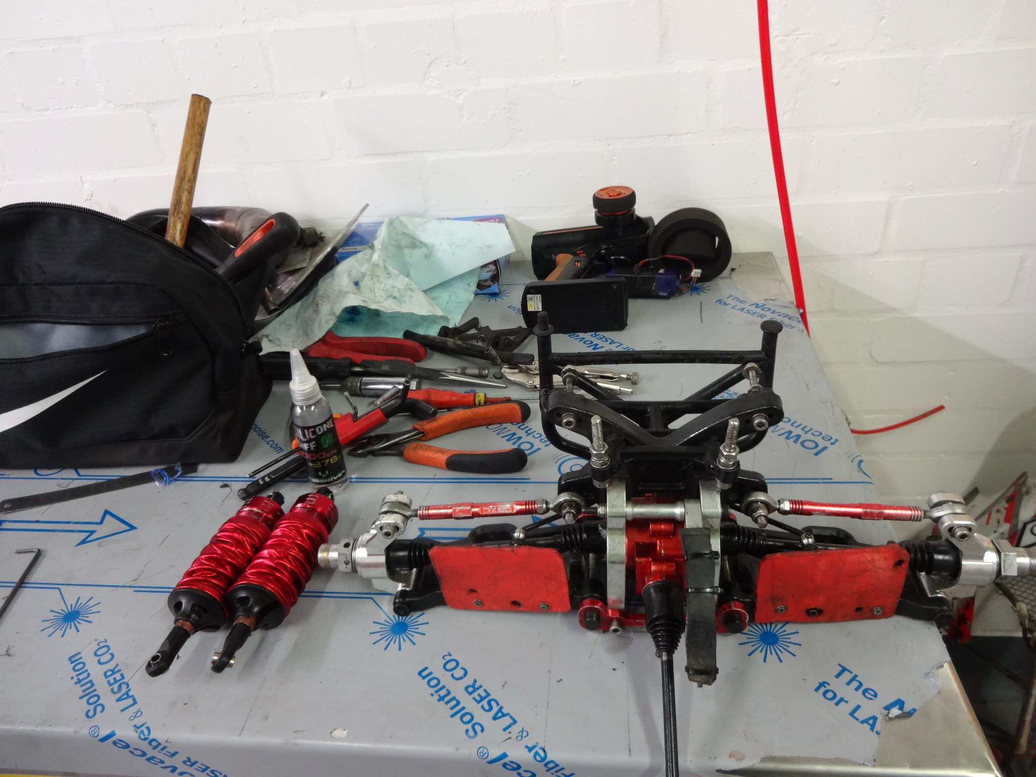

rear clip, diff complete overhaul, shocks serviced and fresh fluid

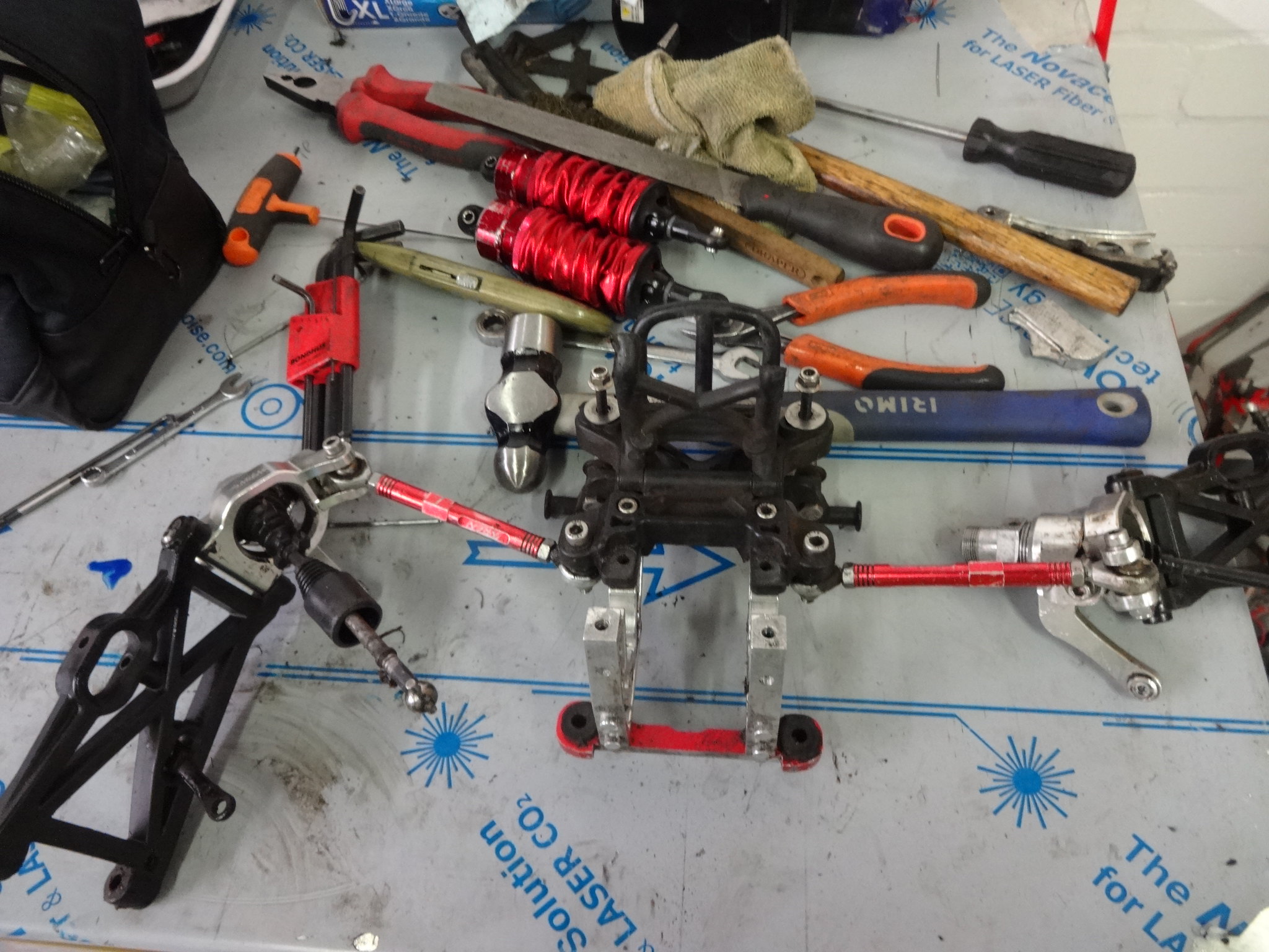

Front clip, diff complete overhaul, shocks serviced with fresh fluid and drive shaft replaced as pin came loose and wore out the CV knuckle.

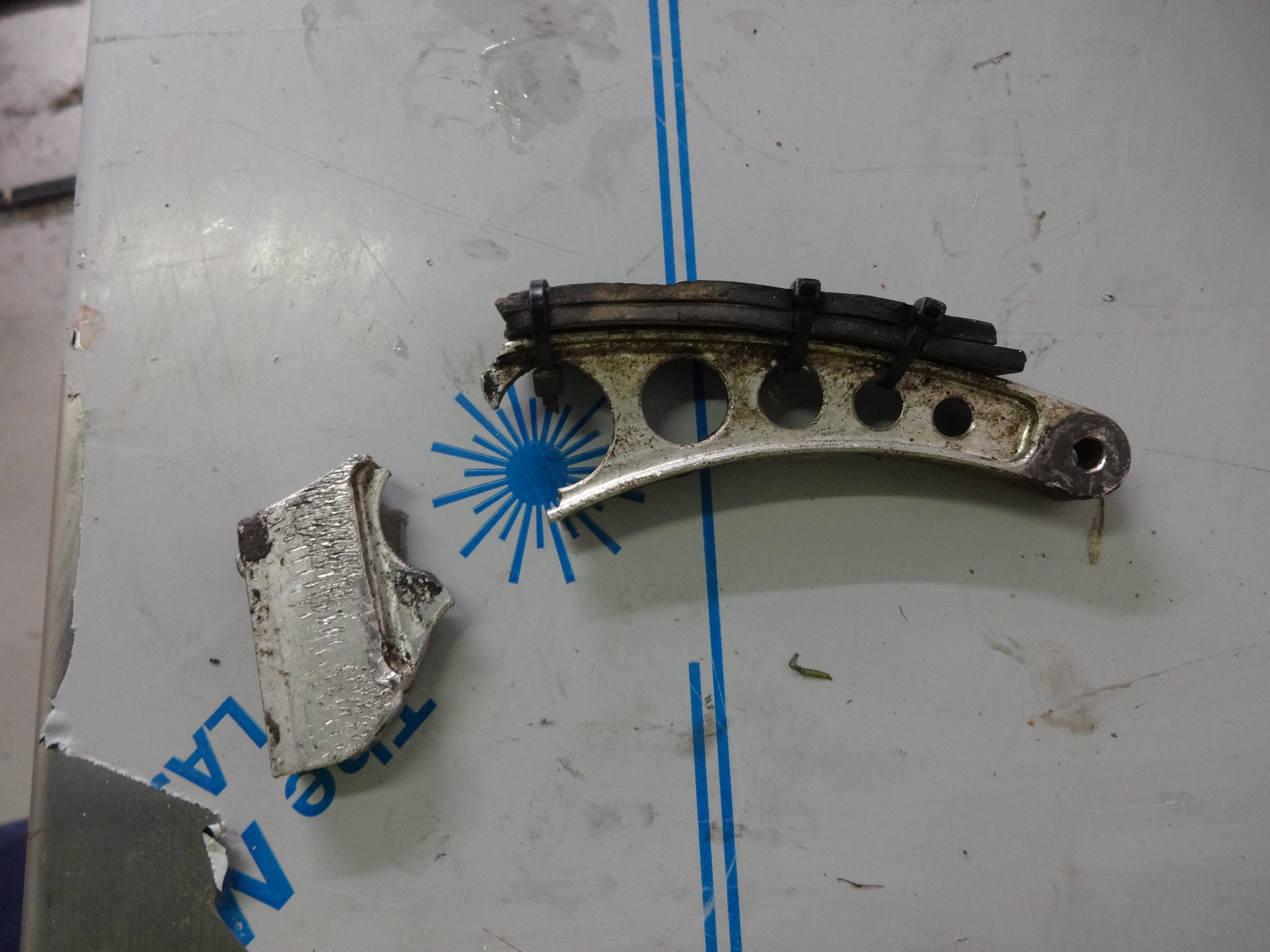

Rear chassis brace Kaput, new ordered.

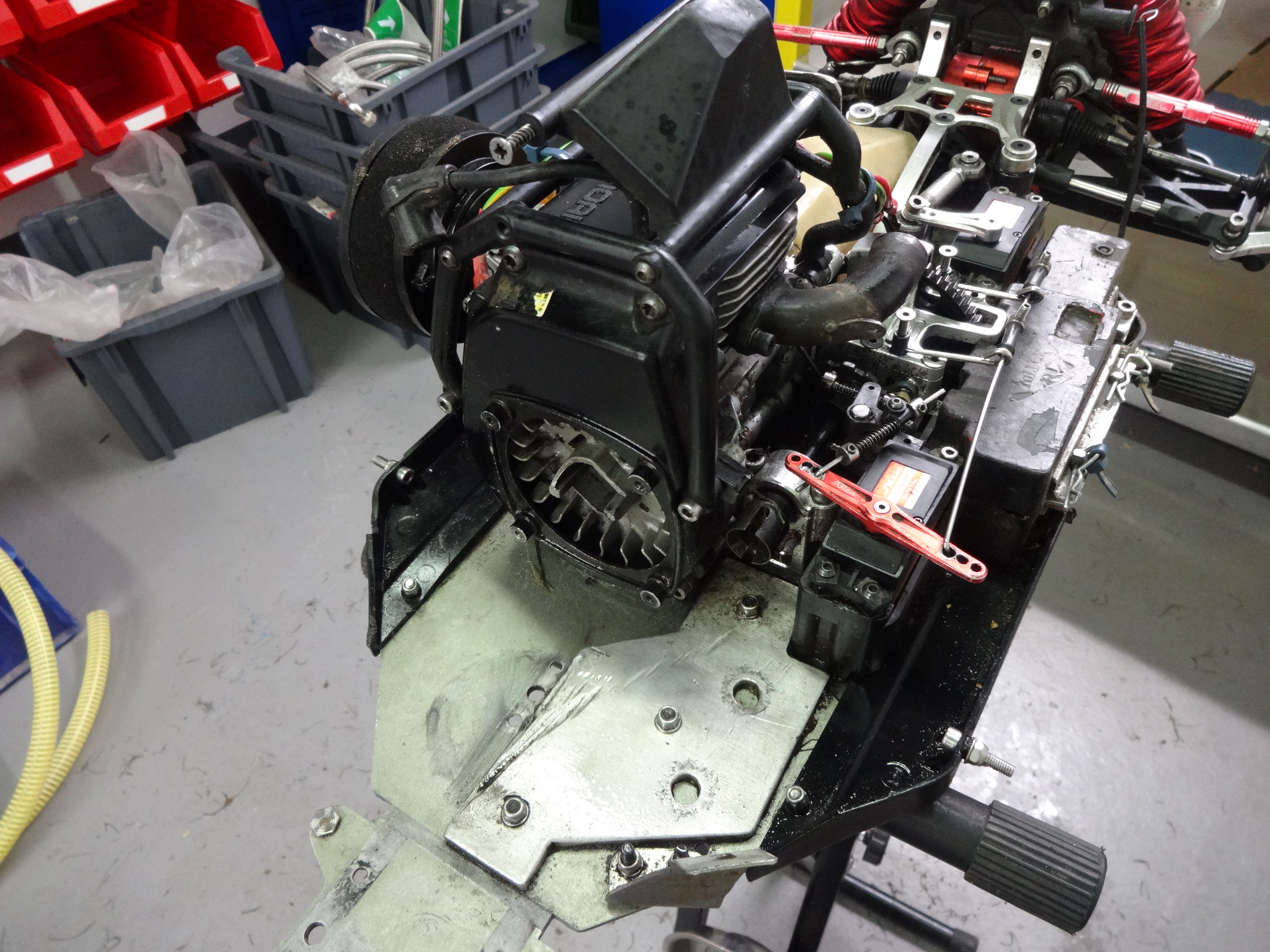

Better view of chassis strengthening plate fitted

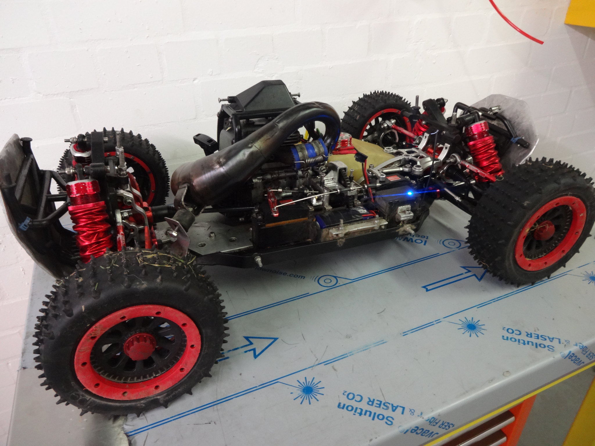

All back together, had to straighten a few track rod ends and realign camber etc, generally in good shape again and ready to run when chassis brace is fitted.
