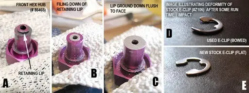

if its the HPI baja, there is a C clip.. You will want to tape a screw pattern in that hole and just put a bolt there instead of the c clip... When you run the baja, sometimes the wheel pops out because of the c clip.

Yes. Get a washer that fits around and then tap a hole. There are a few tutorials on how to do this. It will be a great mod to do. It used to mess me up every time i would loose a wheel..

Rhales, that is one of the best diagrams that i've seen of it. Good find.
You will have to Dremel off the e-clip retaining lip until it is flush with the bearing inner diameter.

Cheers chris got one in colour but not much info or write up
