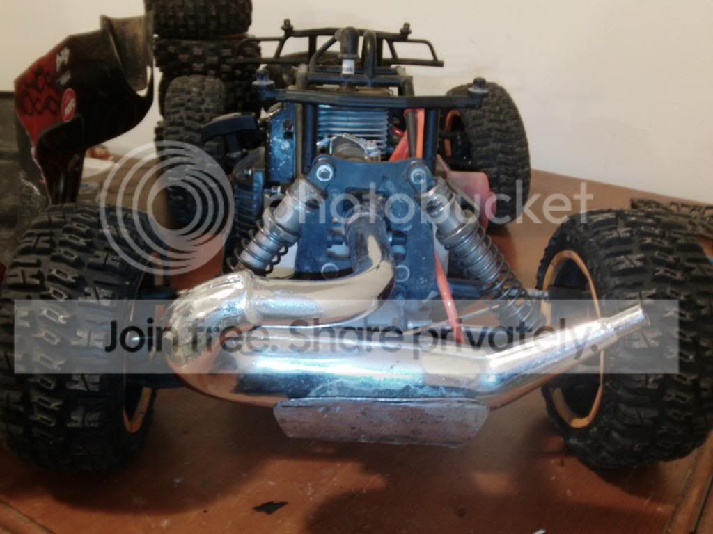

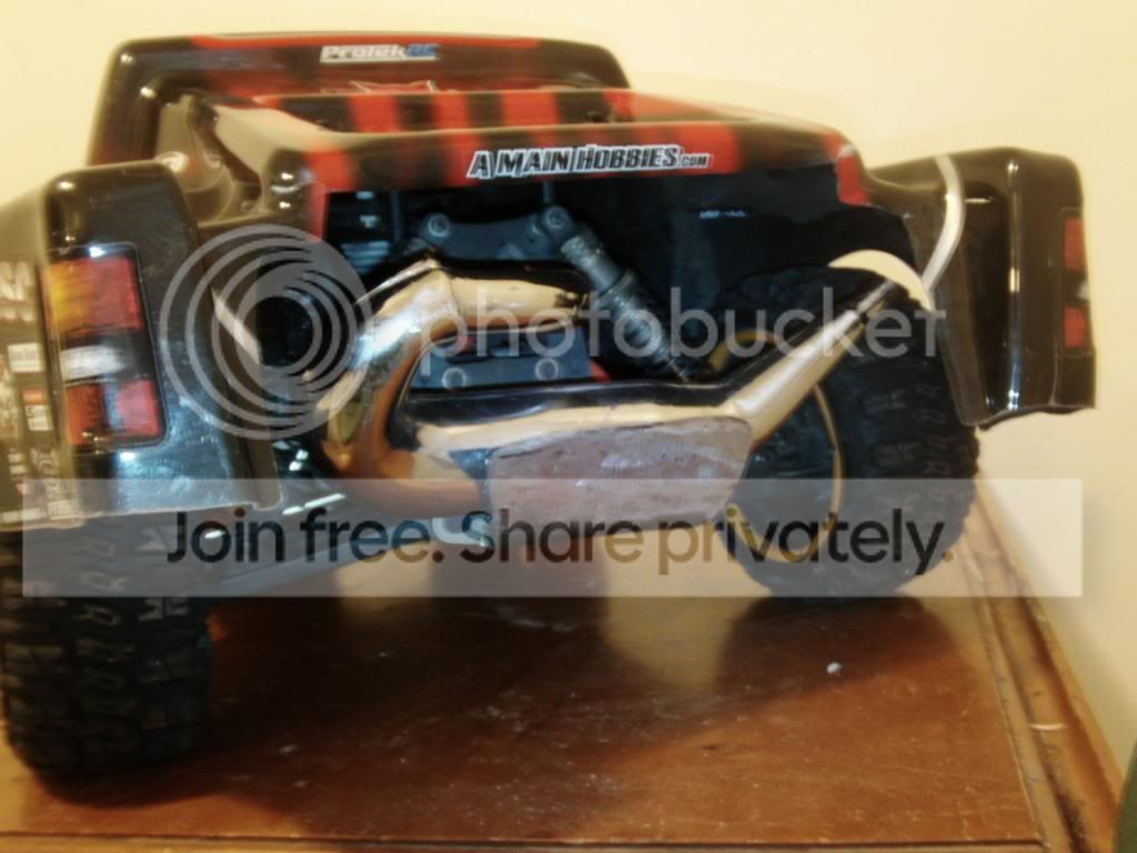

I also did the rear dom and ran it through the shock tower in standard position with a poopy custom bumper mounting plate
poopy?- looks good to me dude! - heck, if there are no leaks @ the joints- and they hold up to abuse-- you hit the jack pot the way i see it-- more power to ya!!
It works and mine hauls butt with just a cy 29 in it and the v1. I was concerned at first with the rear tire heating up but haven't had any problems with it at all. I don't even run that little 90 on it anymore.
That looks great. Does your wing keep the pipe from making contact in a rollover?
