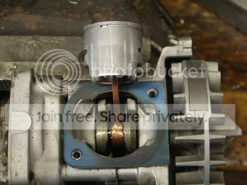

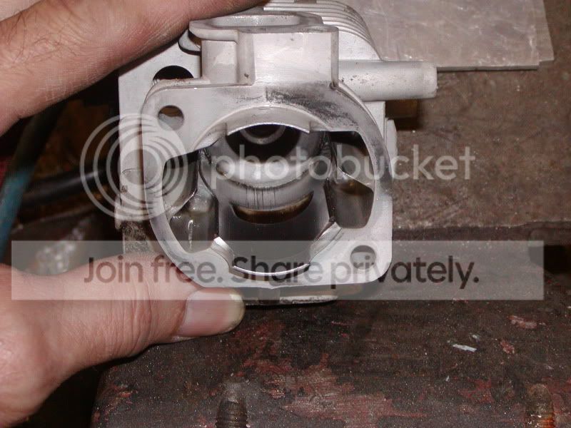

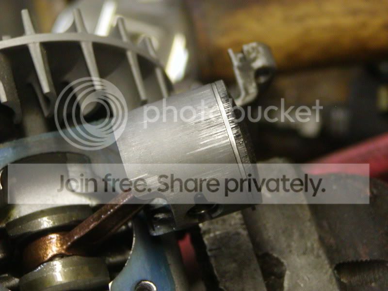

ok guys, piston and sleeve look ok, no visual marks that i can see. now, when i put this gasket on, is there any special methods as to tightening down the head? certain torque amount, or do i just crank it on down? any other info i should know about? installing copper gaskets all around and locktite-ing the head screws this time...
