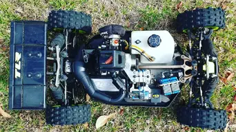

Been setup with x2 different radios. First a spektrum dx5s , the spek 💩 the bed 😂 so I bought a futaba and setup up dual servos. All with the same servos since August 2018👍🏻IMG_20210423_150100_999.jpg
So you don't need anything but patience and a manual
