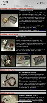

The description for the system I showed you is a bit vague, but in the picture it looks like there is plate between the carb and head which the NoS and fuel connect to. The whole thing is ECU controlled.
