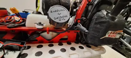

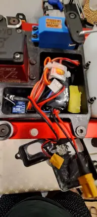

I ended up with a hilantrics after another dynamite fail. Changed my radio to one who's reciever can handle 9v so I don't need the reducer. And made a little window like in a PC case to see status. Not sure if any of this helps.... Mine goes through the chassis under the f/tank into the rad box. I'd just solder an extension if your wires aren't long enough. Hope any of this makes sense/help.
I can't thank you enough man! This exactly what I needed, I'll be copying what you did, I'm leaving work early to go install it right now, how did it fail? Mine seems to work perfectly. Thanks again for taking the time to take pictures and everything, thank you thank you
Don't know exactly. Maybe vibration? It's not the first I've heard fail. On the plus side the hilantronics are half the size.
