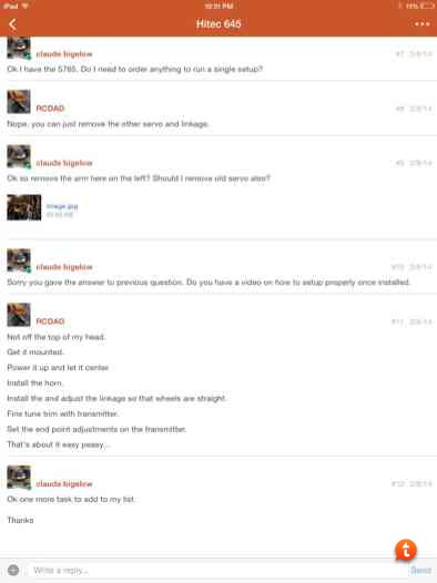

Here is my question. What is the process of installing my new steering servo? I know it currently has 2. What needs to be done to change to this one new servo? I assume this has been covered so if someone could provide me with a link, I would be greatly appreciative.

I am having trouble getting the 5765 to fit where the old servo was. The mount holes don't line up. :(
I found the thread on modifying the servo mount for the 5765. I will have to go snatch up a cheap dremel tomorrow.
I went ahead and drilled new holes by hand lol. And used my dogs fingernail trimmer to cut off the top nubs lol
got it done. I am very proud of myself lol. I like how it cleaned up the truck and made it feel much less cluttered.
