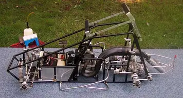

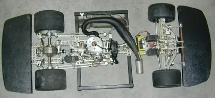

Here is some.. Have to find more. I know I have them. Just depends which hard drive they on and which computer.
Raco outlaw. I got bored one day and put our front end on it. Now had a fully adjustable setup. Looked funny with tires hanging out but ran killer.

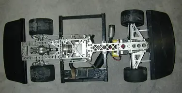

My Grand National. We built the chassis and made it bolt together so you could change sections as needed. People called it the Erector set. LOL

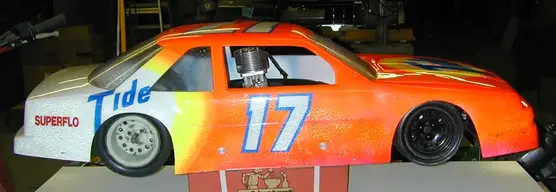

Installed in the Grand National is one of our 35cc marine engines I made a cooling head for after I cut off the water cooling jacket. Ran it on alky/nitro and used a glow plug. Unless you got close to see the glow plug setup on it. You would never guess it had no ignition on there. Just glow plug. It idled and ran that good.
