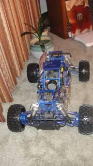

Well haven't been on the boards to much lately but for those that don't remember, I have a Rampage MT Pro with just about 4 tanks on her, after the initial problems i had (servos, gears etc) which were fixed with a simple call to Scott@VancouverHobbies, after that she's been running like a champ!
unfortunately she hasn't been touched in around 4 - 4.5 months, this being due to school, building a garage, and an early snowboard season :p lol
but because were just finishing off our garage, ive been sorting through some things to get ready to move back out, and i found her sitting in the corner, all dusty so i pulled her out and well i have been tinkering, and dreaming for the last week :p
anyways picked up some new hardware, and rocco_van asked me to throw up some pictures of the wheels when i had them mounted, and well i wasted no time, i still have to install the shocks, but i think im gonna wait on that for the garage that way i can rebuild my old rears at the same time, let me know what you think?
The Hardware :
and the outcome of the wheels:

Nice MT pro man! I love mine, what gear your running with those bowties?

Looks good man! ive been thinking bout some lights for my rig as well, what else have you done for your truggy conversion? right now for gearing i have 29/31/25/25 and they're metal gears.
i think my next thing to do it a headkit/pipe ive got the itch for more power Lol
I forgot you had the pro version shocks with the rezzies. Put the rezzies on the shocks you got from me since the 6mm shafts take up a ton of room in the body and are hard to get right because 1 drop too much oil and hydro lock! Rezzies make the whole deal better.
As for your missing part, go get an hpi baja rod end at gogo, i'm sure Cam has a spare lying around then install an hpi ball end as well into the ramp steering knuckle.

All I did was add the Wing mount supports, wing mounts, and wing. I kept the MT back bumper, I just had to move the braces considering the wing mounts use the same holes. Im also ditching the rear body mount, and using the wing mounts to secure the rear of the body and the wing together. Once I do that I could raise the body by just undoing the front body clips aka Pro Stock drag race car style.
