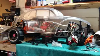

I'm using the FID brakes on my 5b and they work great. The FID master cylinder mounts as shown but I cant tell from the pictures of the KM unit if there is an adapter or not.
Best picture I have available but the master is red and attaches to the Phat Dad brace and 5b chassis you can see the brake lines.
Let me know if you need a better picture ----If you're using Hostile hubs the brakes won't mount ---I found that out the hard way. They work very well with the stock hubs.
I sure would like a better picture. As for the hubs I am going to run Bishop wheels and tires so I will have to make up some hubs. I have found some smaller diameter rotors to fit inside of the wheels.
